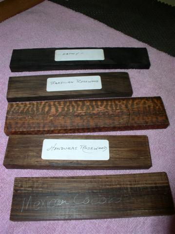

First I select the materials.
Pictured below is an Ebony blank, one Brazilian Rosewood, one Snakewood, Honduras Rosewood and a Mexican Cocobolo blank.

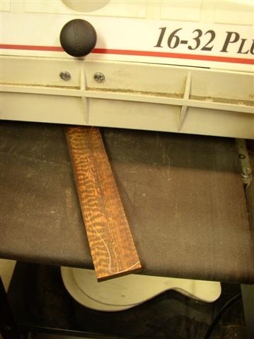

Here I'm thicknessing them to all the same thickness using my performax sander. Lots of passes, a little at a time.

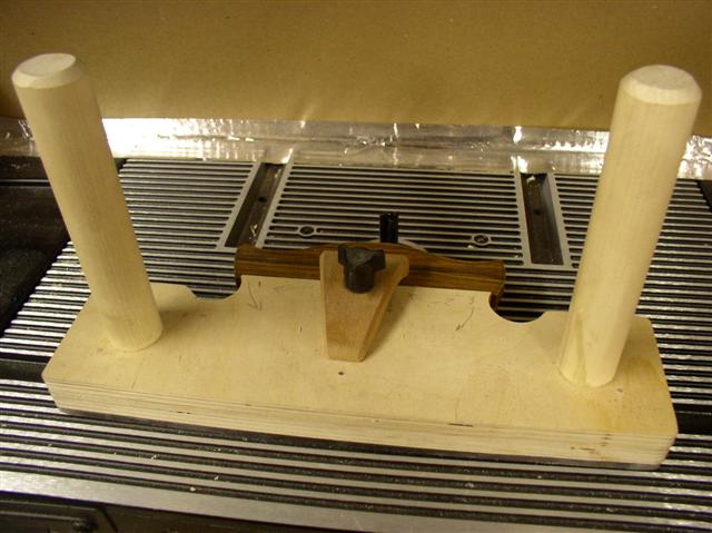

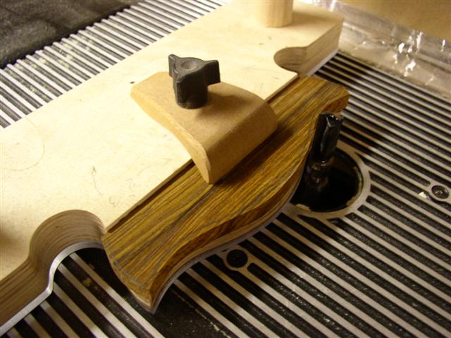

Now they get shaped on my router table using a jig John How made for me. But first I trace the bridge out line on them and rough cut the shape on the ban saw, leaving about 1/8" to trim off on the router table. More than that and it gets a little dicy..

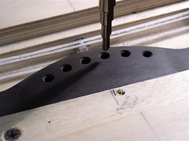

Here I have the bridge blank held firmly in another jig used for routing the saddle slot (More on that later. After drilling the holes for the pins I use a step bit to counter sink and chamfer the pin holes.

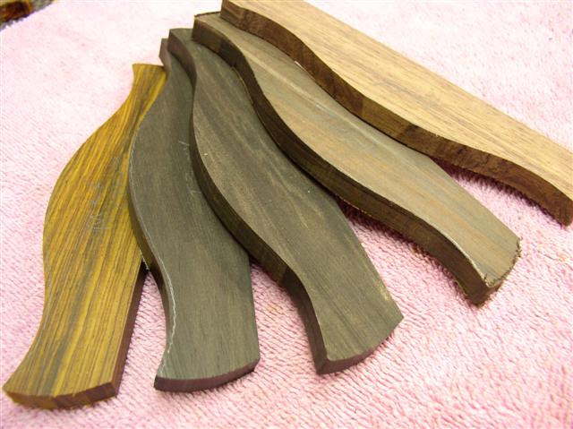

Here they all been shaped to there final size. Part II I'll profile the top using my Luthiers Friend & Robosander. And route the saddle slot.

I really need to make me one of those router jigs. It woul sure save time. Thanks Lance, that way helpful.

Thanks Lance. Hey how do you like using snakewood for a bridge? It looks very nice. Would you then use snakewood for bindings and headstock material? Look forward to seeing the rest of the tutorial. Have a good evening.

I was going to comment on that nice looking snakewood as well. I have a blank ready to go for a guitar I am building for my sister. It has snakewood bridge, binding, and Waverly tuners with the SW buttons.
Where did you get the SW Lance? I'm always on the lookout for more suppliers. I bought my blank from LMI and they are the only ones I have found who sell SW bridge blanks. Also does anyone know where to get SW fingerboard blanks? I have seen de Jonge use a lot of SW on his guitars and I really like the fingerboards.

You can regularly find them from an ebay seller.... I think he goes by the moniker "thewoodjunkie"... but I am not 100% certain of that.
They are usually $20, or $22. I just found him. The blanks are nice. Expensive... but nice.

Steve- you bet it did! Truth is, I needed to make (one) bridge for a current guitar, but I couldn't resist making a batch of them using the wood you sent. It was a virtual buffet of smells With the Brazilian winning by a nose over the Honduran Rosewood (Very nutty. I figure a nice selection of bridge woods will make a creative looking picture for my website.

Yes - go here and see John How's How to in the jigs section, I forgot all about this...
John Hows HOW TO

That is very cool Lance. I am inspired to do that. I always cut my bridge slot first, when the blank is "in the square". I bought that small Grizzley milling machine and just use it pretty much for bridge slots. Overkill for sure but the milling vice likes parallel surfaces to clamp to.
I really like that step drill idea and will go to the hardware store today to get one. Excellent!

Thanks John, ya I actually stumbled on that
The drill was about 20 bucks IIFC - I bought it to install a end pin jack.
My jig that John made me has an angled block that holds the bridge blank at the proper angel for the saddle slot.
Pretty sweet jig i think.
John Hows good at coming up with them ideas ..

John does have a nice milling machine, but you can acomplish the same thing (saddle slot) with the John How jig and a lam trimmer.

Glad to see your getting some use out of that thing Lance. I use a counter sink bit to chamfer my pin holes but it all does the same thing only different. I have resized my bridge so had to make a new shaper jig. I still need to come up with something cool to handle the vertical profile, I usually do it freehand on the drum sander.
